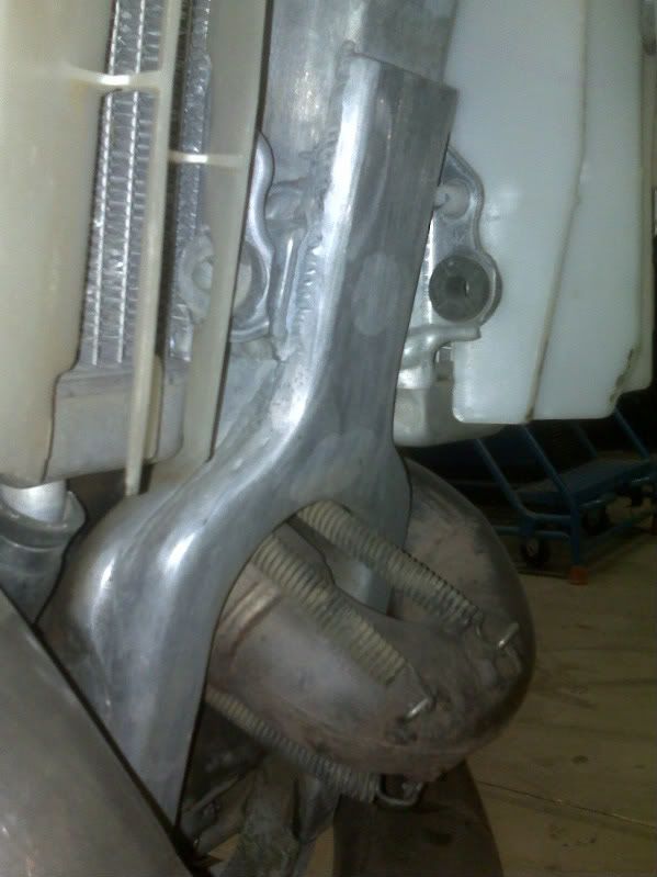

A shot of the reworked piece along w/ a missing radiator bolt. :lol:

That is a very interesting way to not to build it. I understand why Rjacks approached his first build the way he did much better now. The way that is cut and re-welded at such a sever angle creates a very weak spot right where the crack appears. Flowing lines are not just for looks.

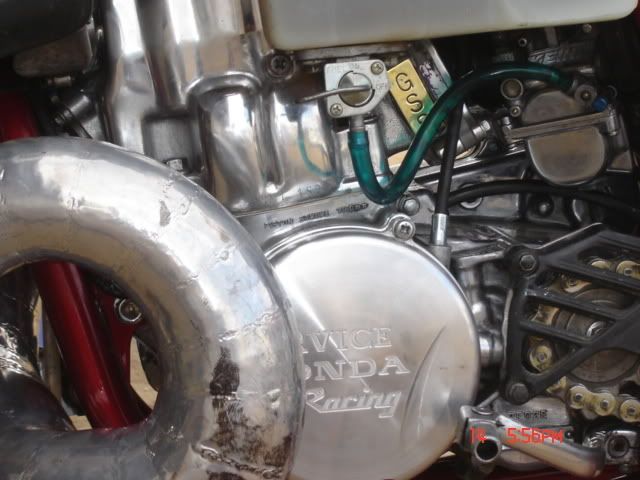

Ill be sticking a fresh GSS motor on NO2 in her so she will live on here is a photo of the motor.

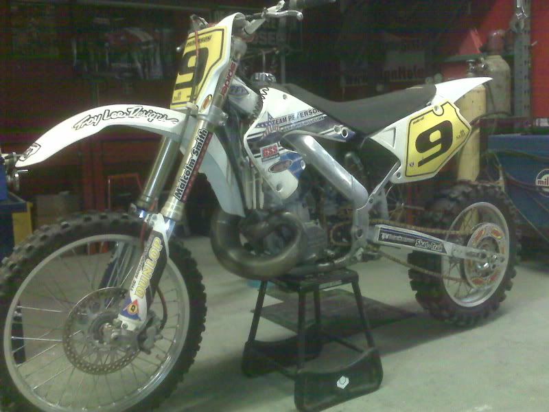

Yo, Jay. I was wondering which one of the Lewis Clan will be riding the new steed in the stable?
RP
I dont really know yet, I think Ill have to take it for a spin before Ill know that
teemtrubble is using the motor and lewisclan is using the chassis ??

AJ's explanation:
well seems everything has been said by the time i noticed the thread.
yes it was an early 2000
my own bike like this , the first gen 2 ,was liklely built in august 1999.
the 00's were the first honda alum frame with a Y,. and
it needed to be modified for fitment.
i put a arched piece in there, to raise things enough for clearence.
i built my own bike ,tested for awhile and everything was fine,
then likley made perhaps 5 or 6 like this.
(obviously robbie got one of those early ones)
I had one fail ,, similar to robbies and
obviuosly started doing the frames completely differently.
every frame made in the other fashion was replaced for free..
and robbie was also offered this .. but opted not to.
many of those bikes had a year or more on them and guys ,
when they did have issues most would return them, and of course we would take care of it no matter how long they had the bike.
that design was not strong enough for long term.
its why ive advised here for years not to trim the "Y" but to relocate it completely in some fashion.
as far as the look of the Y piece,on those very early gen2's
while not pretty,
the only SH ,or AJ work ,you see in the photo-
is the barely visably arch -
99% of what you are looking at is stock honda welds and pieces/joinings.
Hondas yoke wasnt a really asthetically nice piece in 2000. It sjust how they were.
Am i proud of those few early gen 2's (2000)
absolutely not.they were not durable long term.
Where those early gen2's ridden and thought well of by riders like mcgrath and larocco,, yes.(and if i'm not mistaken RP here , won some huge races and perhaps a nat title on that bike?)
did i stand behind every one of them and make it right with my customer at no charge ?
definantly.
and I quickly changed the design ,
and with that new design, there are at least 400 or so gen2 Service Honda 500AF's out there.and 9 year slater doing just fine.
