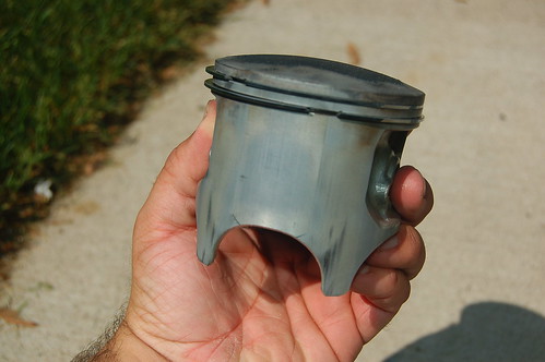

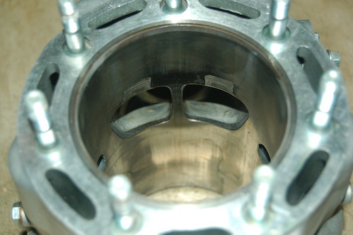

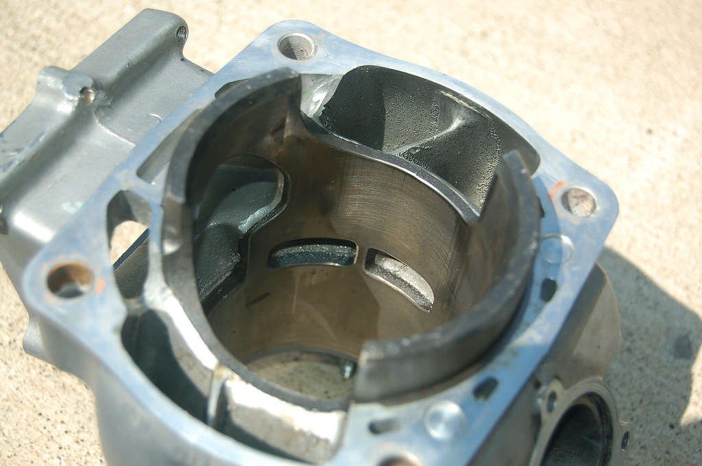

Well I thought I could get away with a stock piston, but I pulled the jug off today and the bore doesn't give me a warm fuzzy feeling. The skirt was hitting on both the intake and exhaust side, the crosshatch is gone. It also looks like there's some rust spots on the bore that haven't worn away, this bike sat for several years not being used so I can't say I'm surprised.
Looking at these pics, should I bore it out one size, or hone it real quick and just run it? If it was a car engine I'd bore it without question, but I'm not sure about a 2 stroke dirtbike engine.

Wiesco's need more clearance, and tolerate excessive clearance better than cast.
Perhaps a forged piston could work, with honing only.
i've done that before ;-) lasted almost a year and a half :D
Blusmbl
Posts: 321
Location: Detroit, Michigan
Post by Blusmbl »
That's a decent idea. Maybe I'll see how it cleans up with a light hone, and try a forged in it. With a Wiseco I'd have to relieve the exhaust bridge, right?
you have to do that no matter what piston. The wiseco recommends the holes though

mic the hole and make sure it is straight.
ya, a hone won't fix out of round...

Blusmbl wrote: Looking at these pics, .......
...... Aren't those cracks on the piston :?:
Time for a fresh top end.

You would be correct, sir. I was hoping to just throw a new stock size oem piston in there, but I'm not happy with how the bore looked.
I think I'm giving forged a try. Danny and his avatar can't steer me wrong. :D
