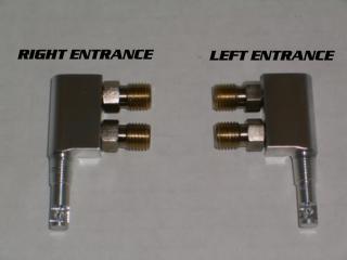

This might work in the left side transfer port....
This one would be even better...
