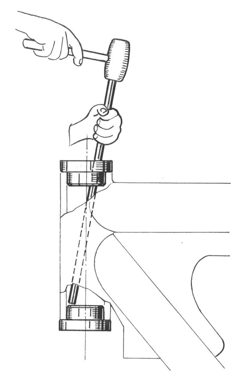

Ok got one question.. The bearing races in the head tube are they pressed in? permanent? can i just take a drift and pound them out or what??? Im assuming they need to be out when this thing gets media blasted as im sure a pitted surface isnt good for bearings.
take a long flathead screw driver and from the opposite side tap out the inner lip evenly and they will come right out. For the new ones, put them in the freezer over night, the take a socket taht is as big as the outer lip (I think a 32mm socket worked for me) and gendly tap in until it bottoms. Done deal, seriously like 5 minutes.
yup

dannygraves wrote:take a long flathead screw driver and from the opposite side tap out the inner lip evenly and they will come right out. For the new ones, put them in the freezer over night, the take a socket taht is as big as the outer lip (I think a 32mm socket worked for me) and gendly tap in until it bottoms. Done deal, seriously like 5 minutes.
I tried with a long drift and it was being stubborn so thats why i got the idea that they were meant to stay.. welp out to the garage to pound harder :P
If you have access to a welder, weld a bead around the race, where the bearing rides.
It will shrink the race, and it will fall right out...
..no kidding!
A drift and big hammer to get the races out works easy as pie.

can i re-use the races or is it better to buy new ones? the ones i hammered out look fine but am just curious.
when you get steering stem bearings, they come with races (when you buy a kit)
best to replace, as with other bearings, the surfaces mate, and should both be replaced at the same time.
