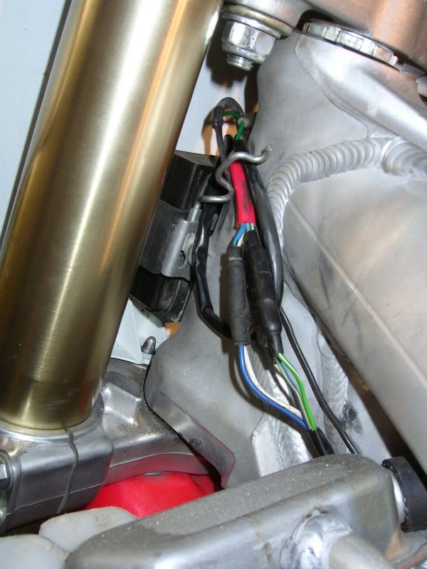

CDI is mounted in stock CRF position, wires lengthened the 1" needed.

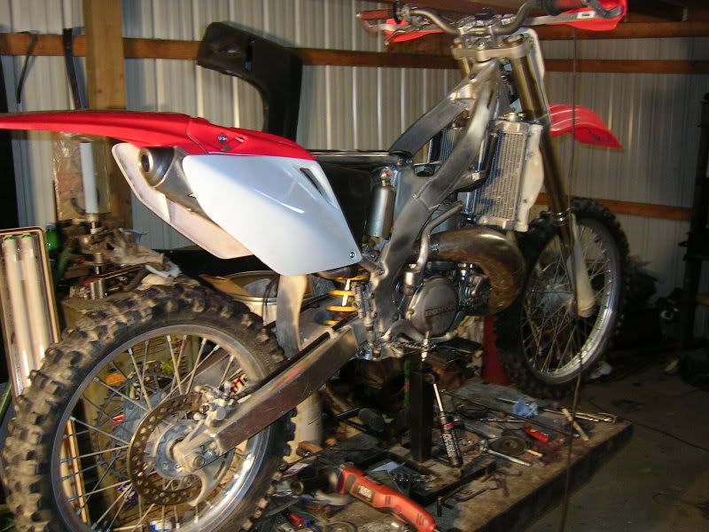

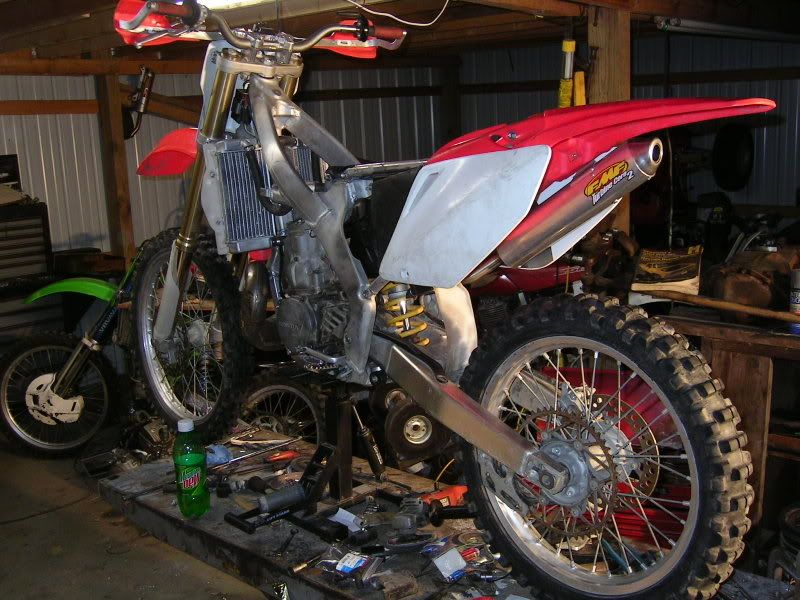

here it is as it sits right now
im ordering the parts tomorrow to finish it so i can ride it.

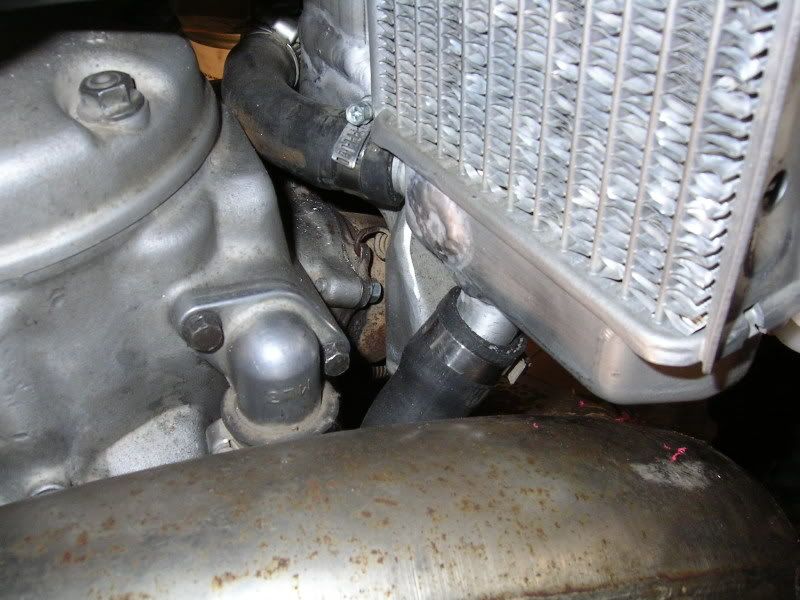

Rads modified

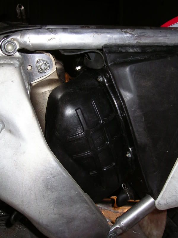

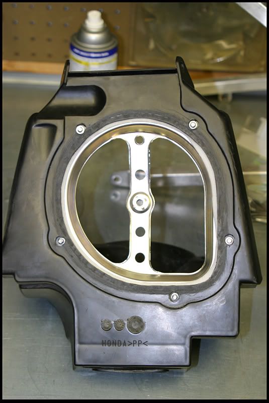

Airbox, i do need to pull it back apart and seal the boot to the plate, and the plate to the box.

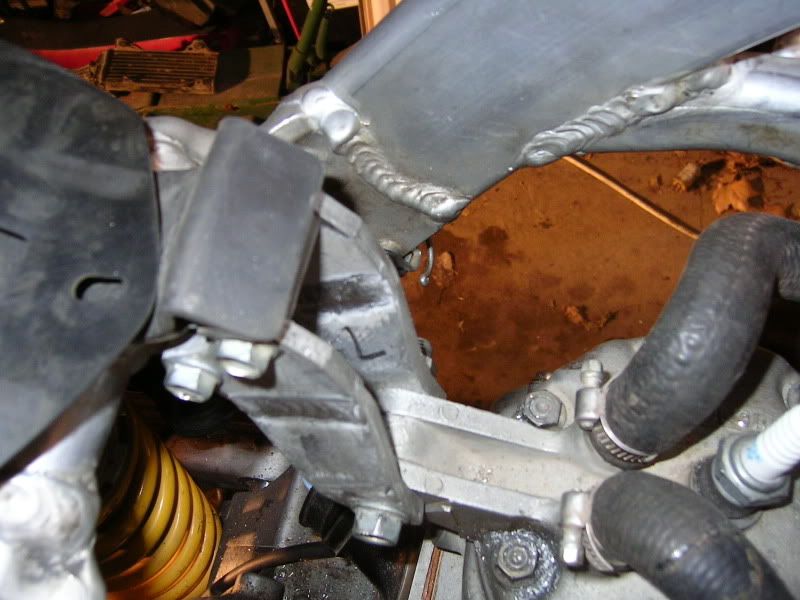

my upper head stay

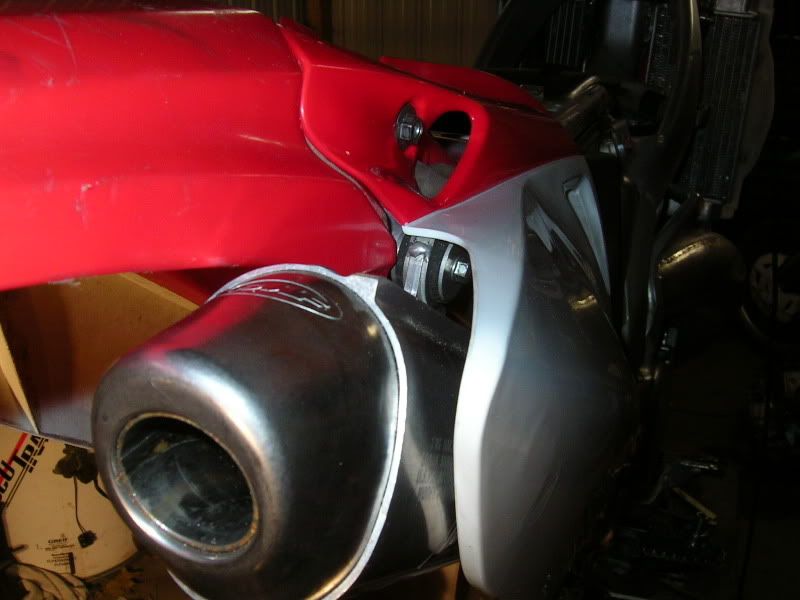

exhaust mounted with 06 side panel

Rads modified
my upper head stay
