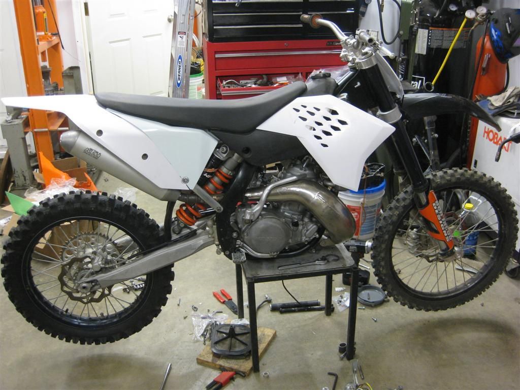

where are the pics? :D
watch out for that carb bowl to not be on too much of an angle, i'm guessing its just the way the picture was taken

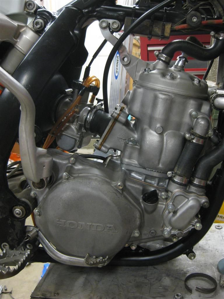

So I finally got around to putting the bottom end together and noticed the shift drum was cracked. So now I'm waiting on more parts.
Good eye!!!!
jar944
Posts: 57
Joined: August 12th, 2009, 7:15 am
Post by jar944 »

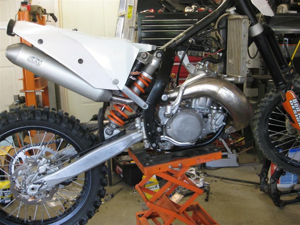

I managed to get the bottom end back together, The silencer changed to a 1.25" core, and a new outlet in the head.

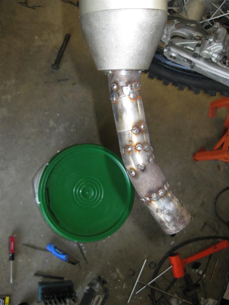

The pipe is the stock 500, the silencer is a mix of the KTM silencer body, a new 1.25" core (matches the the dia of the 500 core) and the stock 500 silencer tubing cut, sectioned and turned from the can to the pipe.

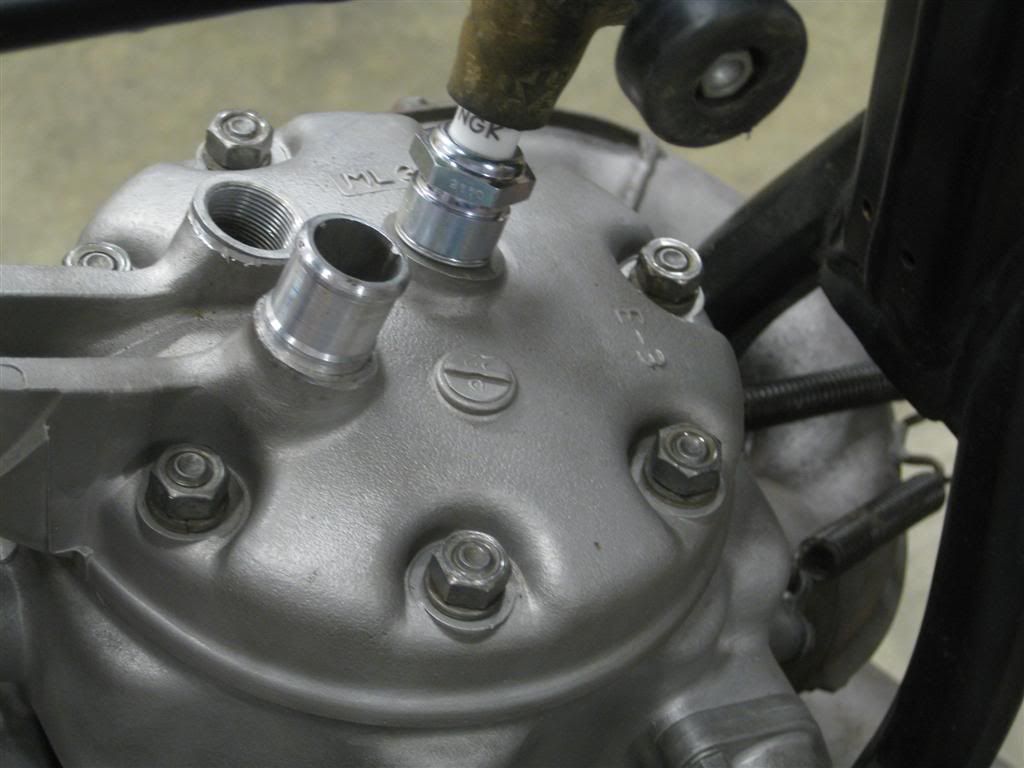

The other outlet on the head will have a plug threaded in.

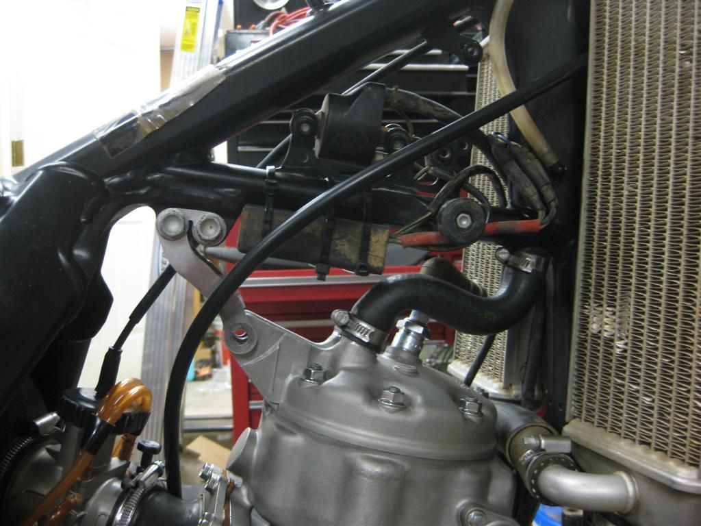

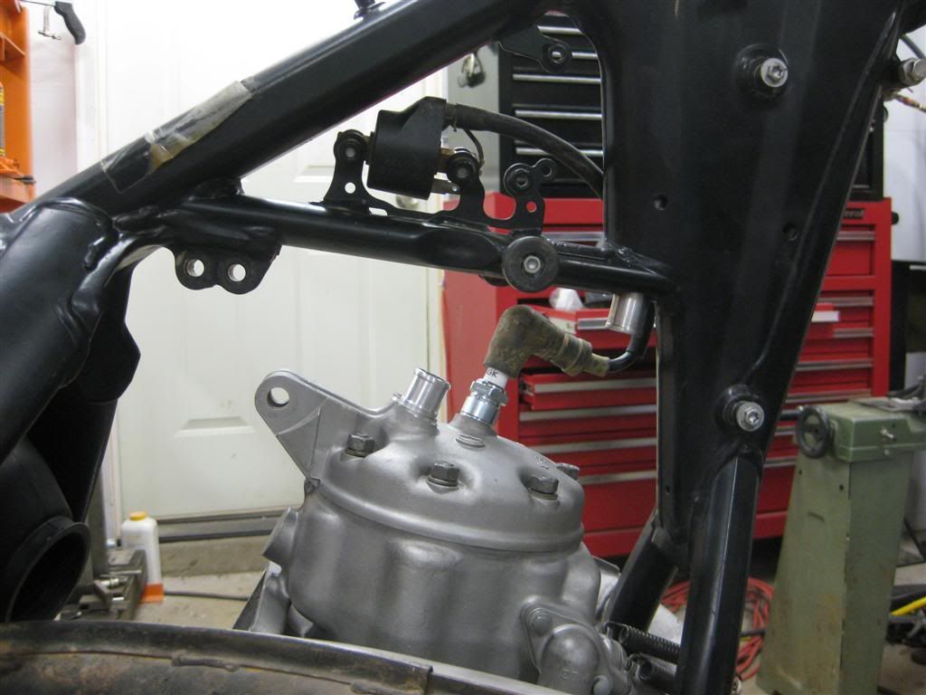

Just some pics of the cdi placement, coolant block off for the head, and carb fitment.
The coolant goes thru the frame? At least thats what it looks like from the pic..
jar944
Posts: 57
Post by jar944 »
hoofarted wrote:The coolant goes thru the frame? At least thats what it looks like from the pic..
Sort of.
All 08+ KTM's have through the frame coolant pluming. The top of the rads have a outlet that fits directly into a "T" fitting inside the frame.

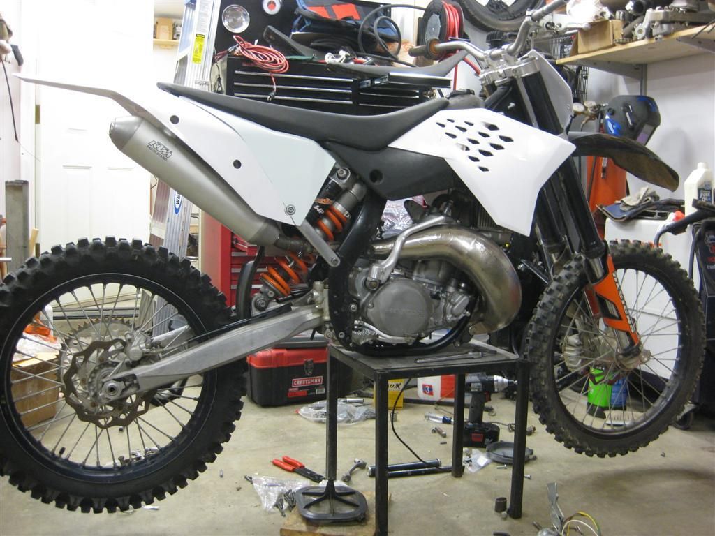

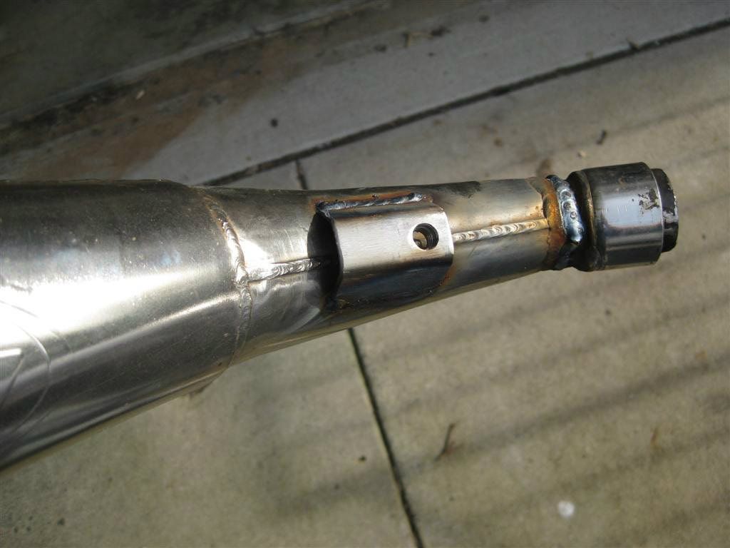

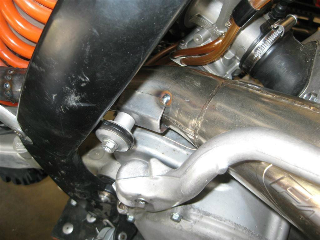

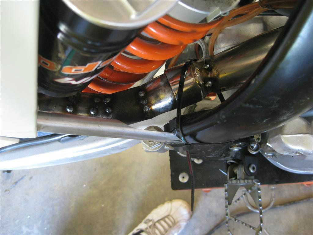

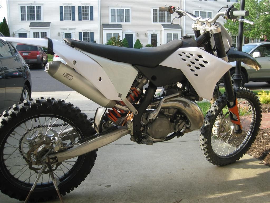

I wasnt happy with the exhaust mounting and routing so i decided to fix it
tweaked silencer
way more clearance
rear pipe mount
The pipe is cut back to the cone and the flange and rear mount welded
exhaust complete
compelted head stays
It's Done. the only custom parts are the frame mounts, head stay and the exhaust and even that isn't much work
also with this conversion I can pull the carb with everything in place (unlike the AF's)
