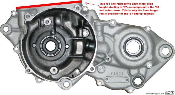

kevin_s wrote:One question I do have is this..where is the exta hight in the jug with the longer rod engine :?: does the exhaust port change :?:
Its 5mm, not 6.5mm ( 1/4")
The whole jug moves up, including the port locations...
kevin_s
Posts: 284
Joined: May 2nd, 2011, 6:00 pm
Post by kevin_s »
Ok thanks for that Bob.

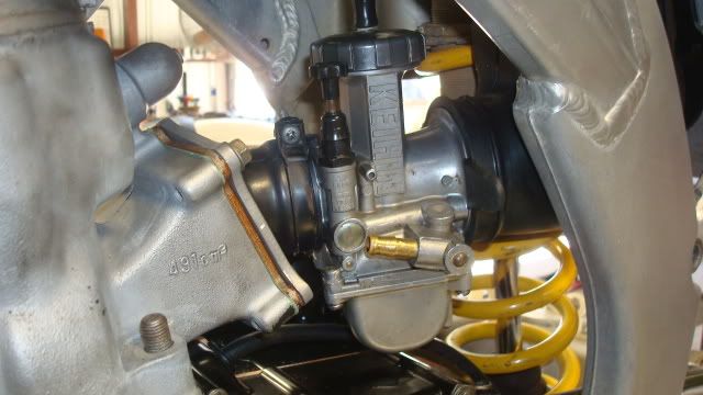

I received my new intake boot today and now the carb lines up nice with the 98 250 air box boot.I'm going to make the air box mods tomorrow.
I did notice I have some interference at the reed cage with the expansion chamber,looks like I might have to dimple the pipe a little bit.
Also,if I can modify the fuel tank outlet I might not have to mod the tank.

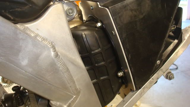

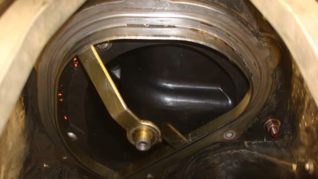

I got a few hours to work on it today.
Air box is done,came out pretty good,carb lines up perfect.
Still need to push in the top of the boot where it hits the frame.
I tried the pro circuit pipe and now we have clearance at the reed and carb boot.
Just need to sell some jigs so I can buy some parts for this one.
Heat up the boot pretty hot....
Shove in a piece of wood to hold it away from the frame
Let it cool overnight.
The boot will relax a bit, so over-do it a little on the wood thickness.
Done.
OR.....
Grind some of the frame away like this dood I know....

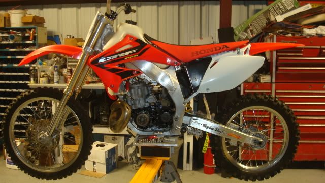

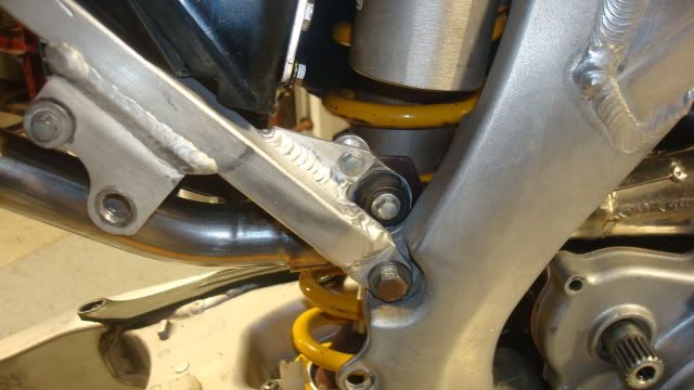

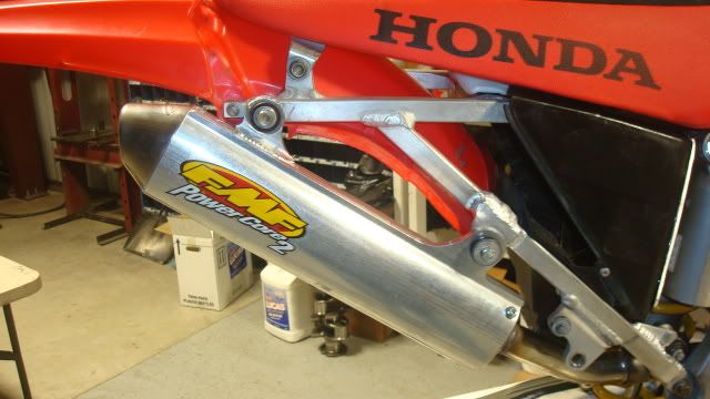

A little progress,silencer mount's are done along with rear pipe mount.
kevin_s
Posts: 284
Post by kevin_s »
Got some more parts,just need to pull it all back apart and re-assemble,maybe ride it next weekend. :D

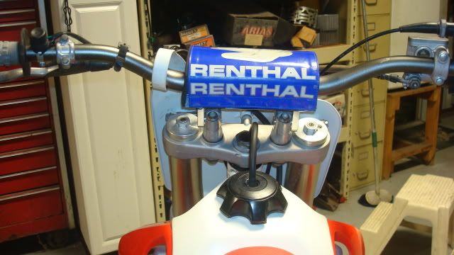

Hey kevin what handlebars do you have on that bike ans how tall are you. Thanks
Kevin
kevin_s
Posts: 284
Post by kevin_s »
[quote="freeride58][/quote]
Hey kevin what handlebars do you have on that bike ans how tall are you. Thanks[/quote]
The bars appear to be cr high bends.
I am 6ft.
Am I going to need risers,?I just put 2inch risers on my steely and that helped me alot.

I was wondering because i am looking for some higher bars and yours looked nice and high. I like those risers who makes them. Bike looks bad ass man.
Kevin
The FMX bars are pretty tall
Pro-Taper Metal Mulisha 1 1/8" Handlebar with Grips Sizing Chart
Width Height Pull Back
Deegan FMX Bend 31.50" 4.25" 2.71"
Metal Mulisha MX Bend 31.50" 3.62" 2.24"
Twitch FMX Bend 30.50" 4.75" 2.17"
