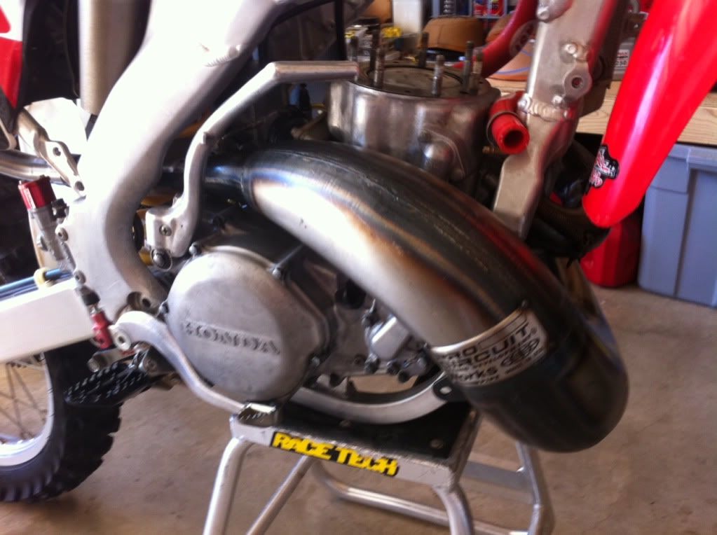

Got my pipe and silencer today... Wish I had a Tig here to fab some brackets...
[imgImage

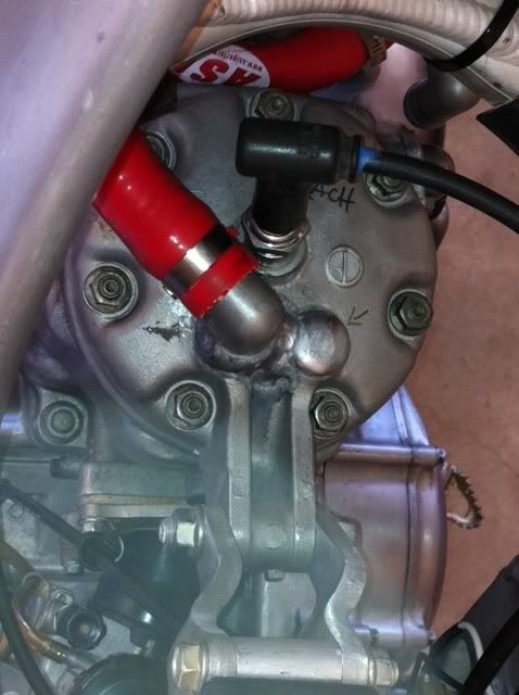

I went single outlet head using the large CRF style outlet
[imgImage[/img]

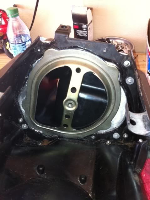

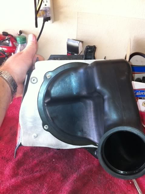

Next was the airbox. I have a 2008 CRF250R and found out pretty quick that the stuff hoons had done on the older 250F didnt quite work. Faceplate, airboot and silencer brackets I made using a flat sheet of aluminum
[imgImage
[/imgImage

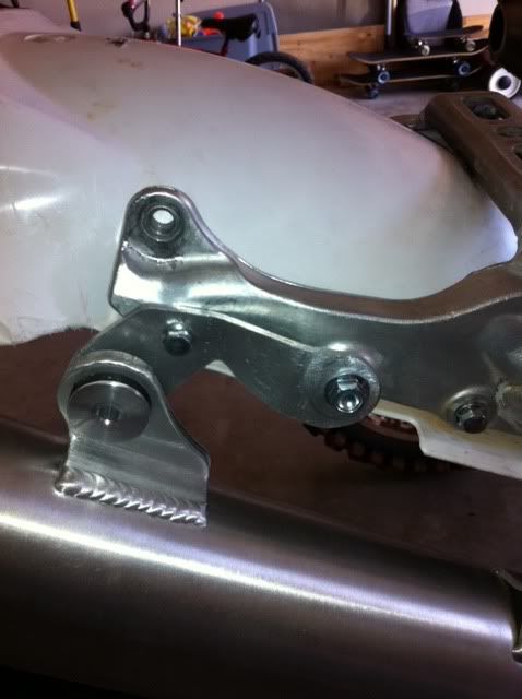

The rear silencer bracket was roughed out pretty quick. I dont like they way it looks, but to be honest...its hidden behind the side plate. I utilized the stock 250 muffler bracket bolt and then tied it back to the rear fender bolt. Once I had the proper bend to match the offset in frame, it came together pretty easy.
Next was the stinger mount...
[imgImage
I cut off the PC mount tab as it was stuck against the subframe mount on the 250F.I flipped it to the top side of the pipe and welded it upright. Then I made a offset bracket using the stock mid pipe mount hole.[/img]
