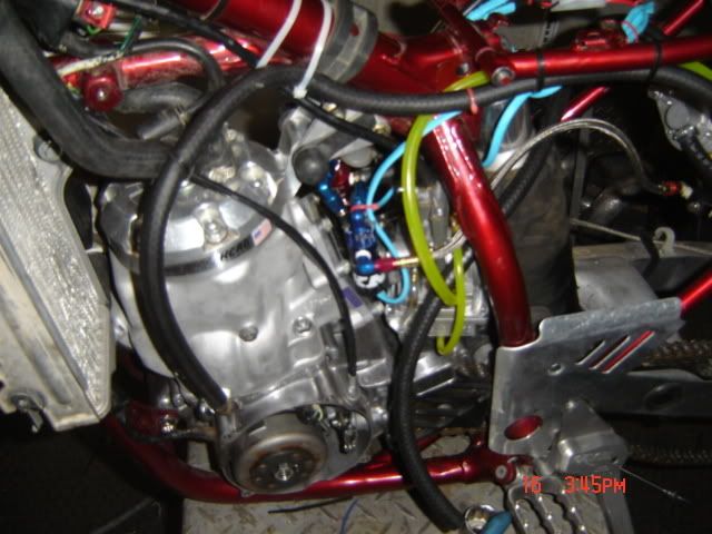

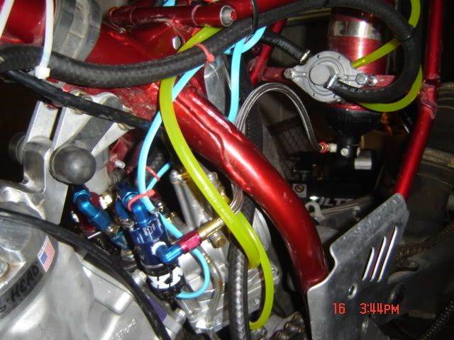

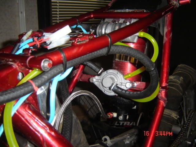

The electric pump line is just conected to the vacumme pump just so dirt wont get in there the vac pump is for the primary fuel the electric is for the injected stuff .

depends what carb. some have 2 inlets. need 2 outlets from pump or pump one side and gravity feed the other. single inlet carb just need one outlet from pump
lewisclan wrote: I never did get this running right
should of dumped in brits hoonshine :D
pumps are real cheap and easy to hook up. cheaper than fried piston
