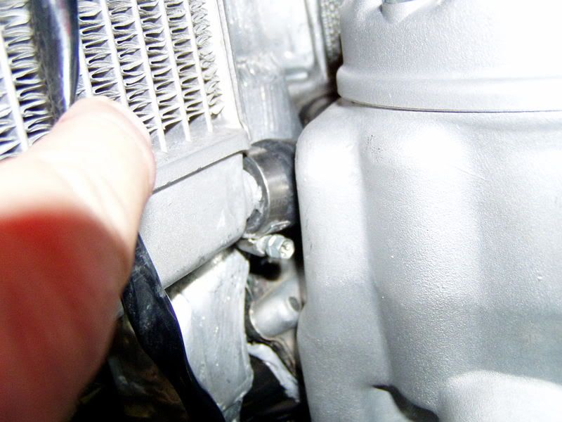

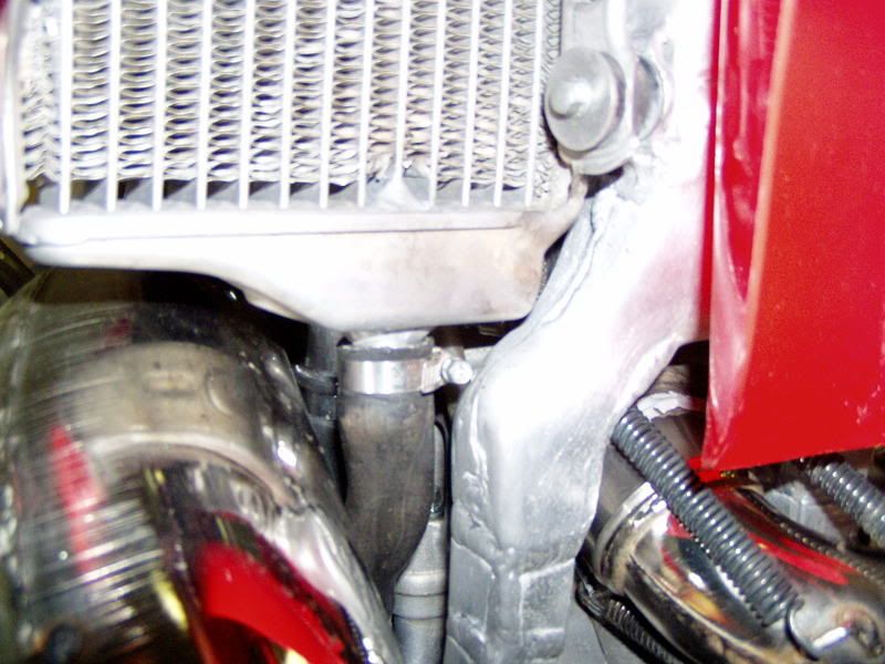

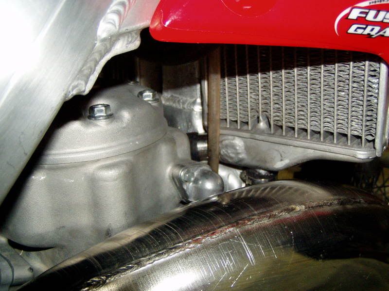

Thanks. I really was wanting to see how close the exit spout was to your pipe. The first pic with the hose clamp, how close is the hose to the pipe?Ported&Polished wrote:Here you go.pimp559 wrote:Got any pics of the hose routing from the rad mod?

BINGO! Thats what I was looking for. How much clearence do you have between the pipe and the hose? MIne touches a little becasue I have a 1" spout and I'm not sure how I'm gonna fix this yet. I'm thinking about denting the pipe or having a little more tube welded at an angle to the spout.Ported&Polished wrote:

Thats a great idea Iggy. The only problem is my welder has a 1 hour minumum at $64 an hour. I was also looking for a cheap fix. Maybe I could get a 3/4" threaded collar about an inch long and cut some threads into the spout? I wonder if Bob's magic tape would work on this? I have no budget right now, I blew my cash on engine rebuild parts. I pick up my Cylinder from the shop today. I can't believe this motor (1992) was on its first piston (stock bore).iggys-amsoil wrote:You could put a pipe, thats nearly the same diameter in there and gently bend it towards the frame. The stuff is pretty soft.
