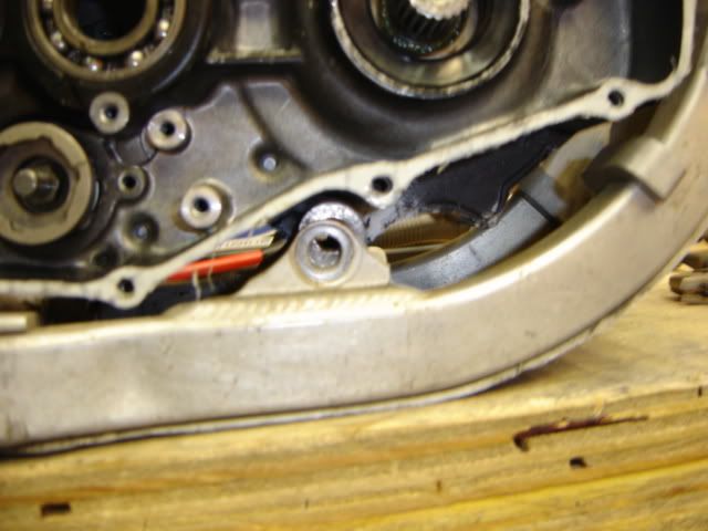

Since then, have cut the mounts, removed the x for now, dimpled the right rail for lower clutch cover bolt clearance and mocked up front mounts.
