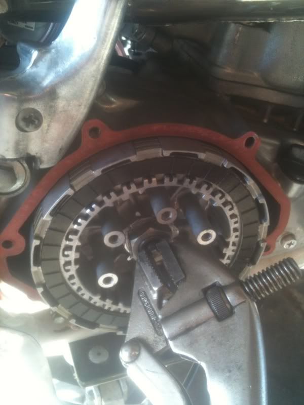

I'm taking apart the clutch on my '01.
I'v removed the clutch hub and rod lever but the rod only moves about 10mm and sticks.Why? Is there anything holding it?

nothing holding it, i use some needlenose and pull it out..
It probably has a burr on the rod. You might have to split the cases to get it out with out fucking something else up...

Getting the shits now...I got the pliers on the end of the rod and pulled like a schoolboy,she's not move'n!
Must be some monster burr? What the f#@k could be holding it?
Does it matter if i leave it as is?
Keep it real, Keep it steel.
the arm on the ignition side has been adjusted wrong and worn into the shaft, it'll be tight, but it'll go.
pull the ignition off, take the arm out, get a phillips screwdriver down in there and help it thru the small pilot hole it has in the casting.

Ok after a long time working on other bikes/injuries I finaly got back to the clutch rod issue.
No messing around this time,out with the vise grips.
Settled down with a beer to a bit of tugging and horsing of the clutch rod.
After a while I could feel the rod sticking as the bur was getting stuck.
Finaly the fecker came out.
Roostius was 100% correct.
It even has a blue heat band near the bur,must have been hammering on the acutator arm.

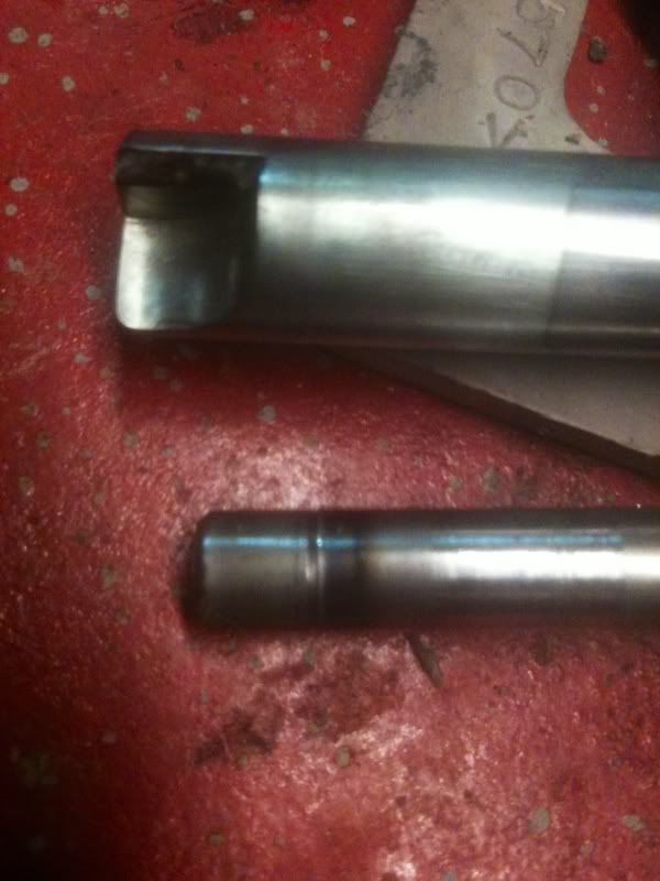

So i got the new rod and arm.
Put the two rods side by side and I can see the wear in the old rod.
The ends are flattened maybe a millimetre in total which I imagine would
have quite an effect on pressure plate movement.
This could why the accuator arm was hard up against the case and the clutch was still not released.
New one on Left lol

New one on right
i knew you guys were upside down.... but i didnt think everything was mirror image?
