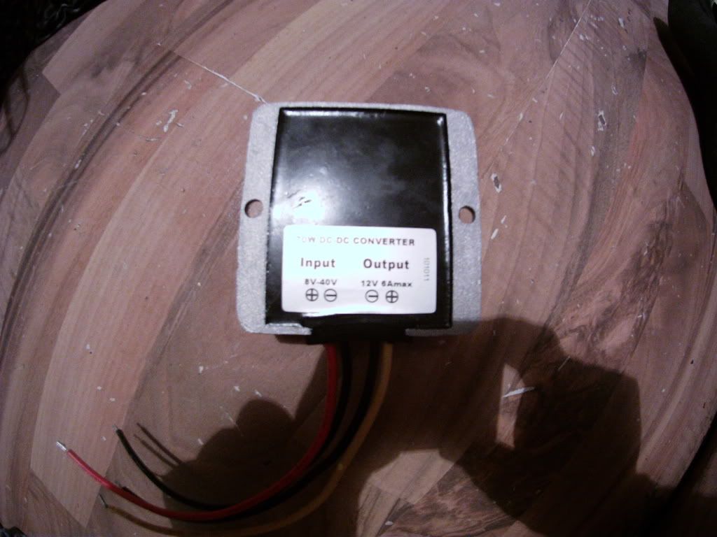

the delta fan ive been using has been great, but a few things to watch out for....
if youre runmning a regular voltage regulator and no battery it WILL kill your fan.... dont ask how i know
if youre running a regular voltage regulator and a battery it isnt precise (ive tried 3, 2 brand new trailtech adjustable too) and when your bike is hot it will trip the built in overheat sensor and the fan will cycle on and off aprox 5 seconds each cycle, on 5 sec off 5 sec.......
and these computer fans rip and are very efficient, but be careful about the wires pulling out there real thin, mine just did and its a pain to put them back together, dont worry about water it wont hurt it, i pressure wash it and its held up
DO NOT MOUNT THE FAN TOUCHING THE RADIATOR, IT WILL WEAR THRU :oops:
if you are using a stator less than 60 watts i would highly recomend using my way of regulating..... otherwise your battery will go dead when youre in the tight stuff
make sure you read this if you go that route, you will need to run a 10 volt system, probably could get away with a 11 volt li ion setup, 12v wont work very good at all
http://www.bannedcr500riders.com/board/ ... rex+stator
http://www.bannedcr500riders.com/board/ ... oling+fans
